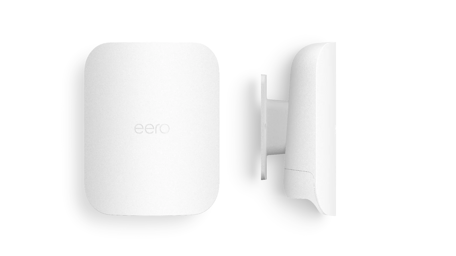

The new eero Outdoor 7 is our first model designed for outdoor environments, bringing the speed and convenience of Wi-Fi 7 to your backyard. This eero device is equipped with a 2.5 gigabit Ethernet port, making it compatible with internet plans up to 2.5 Gbps.
What is eero Outdoor 7?
eero Outdoor 7 is our first eero unit designed for use in outdoor environments. It features built-in support for Wi-Fi 7, expanded range, and durable weather protection, with a single 2.5 gigabit Ethernet port that also provides power to the unit via PoE+. Optimized for its role in a variety of locations and climates, the eero Outdoor 7 supports wireless speeds up to 2.1 Gbps while remaining weather resistant with an IP66 rating.

  • 1 eero Outdoor 7
  • 1 mounting bracket

Without bracket: 6.34 x 8.18 x 2.24 in. (161.03 x 207.77 x 56.89 mm)
With bracket: 6.34 x 8.18 x 3.55 in. (161.03 x 207.77 x 90.17 mm)
