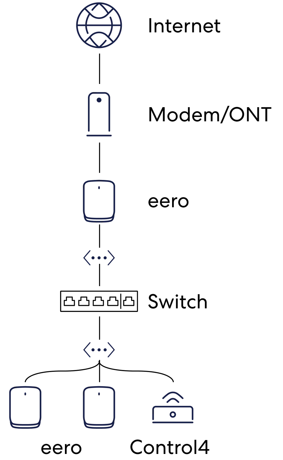

eero with Control4
In this configuration, eero serves as the primary router for the network, with other eeros and any Control4 equipment hardwired to the gateway eero through a network switch.

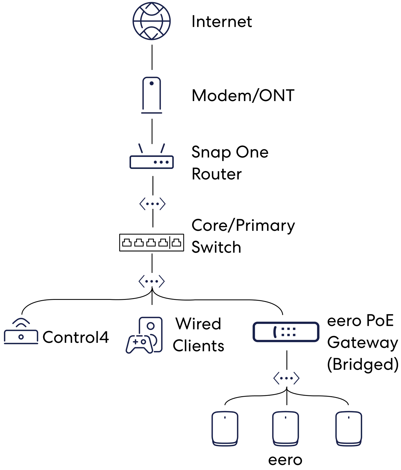

Snap One router with eeros
This topology combines existing Snap One equipment with eero, and uses the Snap One router to serve as the primary DHCP server on the network.
In this configuration, the gateway eero is connected behind the primary Snap One router in bridge mode, allowing it to provide wireless coverage without interfering with the existing NAT.
Additional eeros are connected to the network through a network switch.
Note: The switch servicing the leaf node eeros should have advanced features such as STP and IGMP disabled to ensure stability.

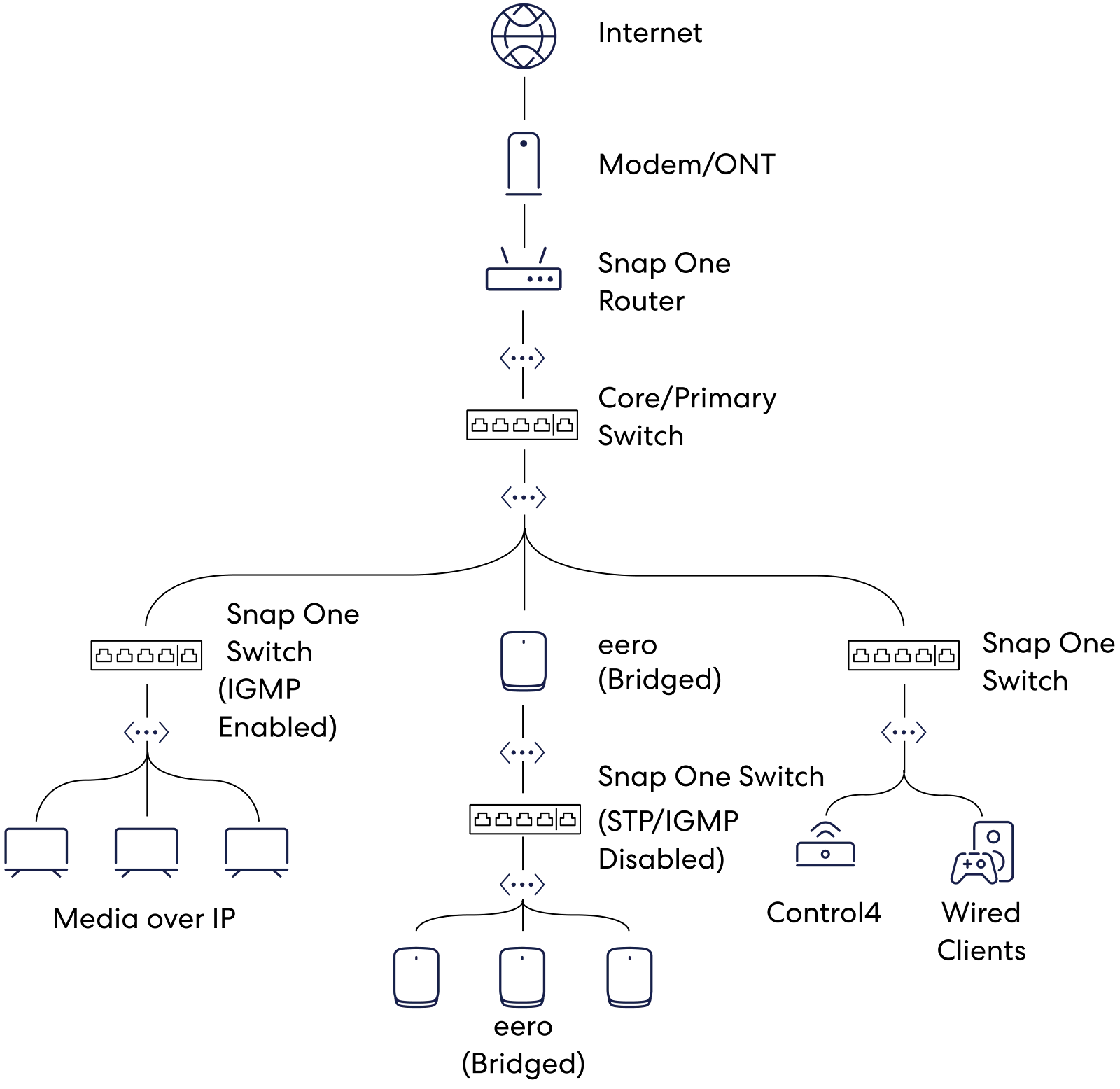

Snap One router with eeros and MoIP
This setup has multiple switches meant to serve bridged eeros, Control4 and wired clients, and a dedicated switch for Media over IP (MoIP).
As mentioned above, MoIP requires IGMP to be enabled, necessitating an additional switch to isolate it from the rest of the network.
