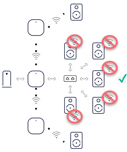

How do I connect Sonos using Ethernet?
For advanced Sonos systems with many (5 or more) Sonos speakers, connecting Sonos speakers to your network with Ethernet may provide a better experience.
When doing so, plug all of your wired Sonos speakers into the same eero or the same network switch, and disable wifi on each of them in the Sonos app. Connect your other Sonos speakers to your eero wifi network, not SonosNet.
Only do this on a speaker that's connected by Ethernet. With wifi disabled, a speaker without a cable can't connect. To disable wifi on a Sonos speaker:
Open the Sonos app for iOS or Android.
From the Settings tab, tap System.
Under Products, tap the name of the room you'd like to modify.
On the following screen, tap your product's model name under the Products heading.
Tap Disable Wi-Fi.
If you can't hardwire other Sonos speakers, connect them over wifi to your eero network, not over SonosNet.
